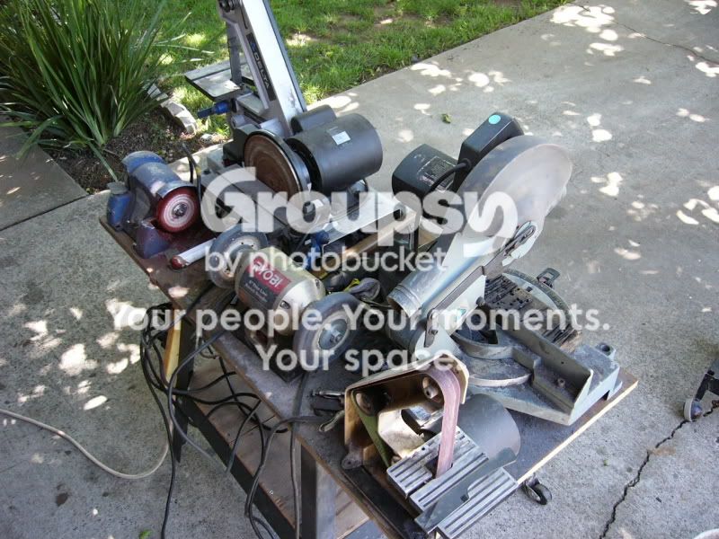

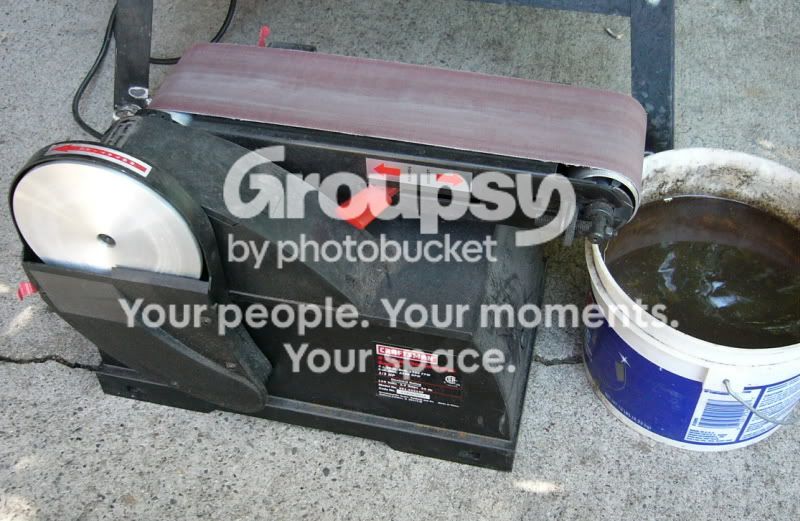

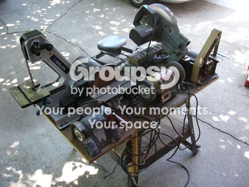

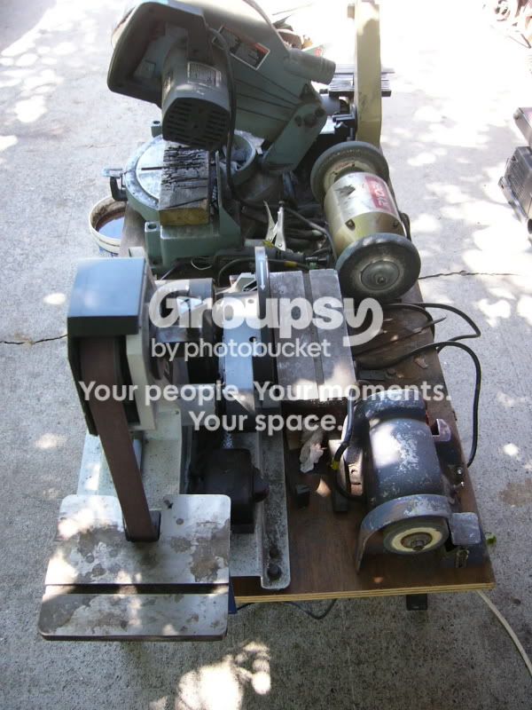

OK, here’s basically all the equipment I use. I and my wife live in an apartment with no garage right now so most of my stuff is set up on one table at my parent’s house. Whenever I decide to do some work, I go over there, ask my brother to help me move the table out of the garage, and get to work :lol: We are moving to a duplex at the end of the month and it has a 2 car garage-can't wait!!!

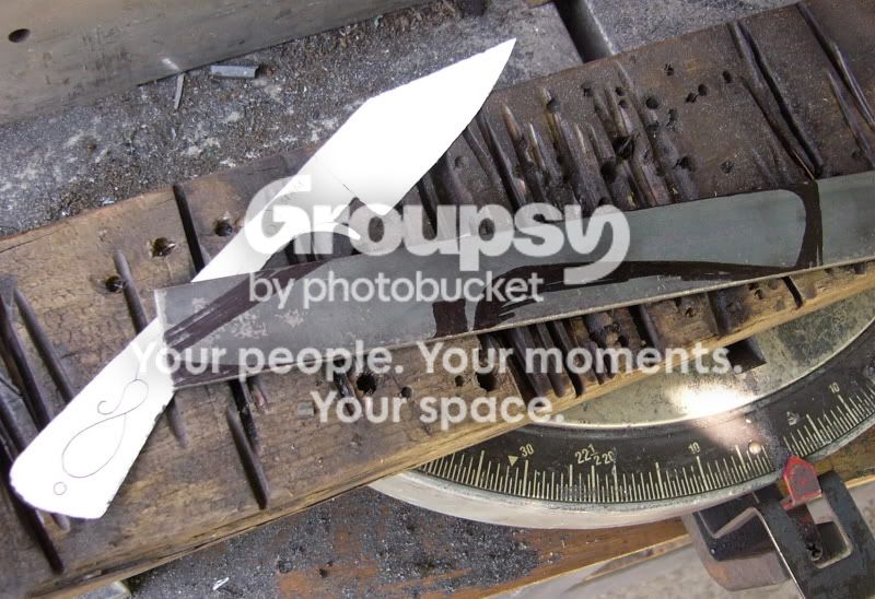

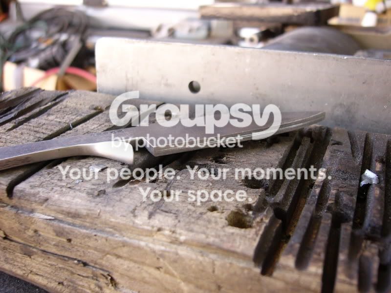

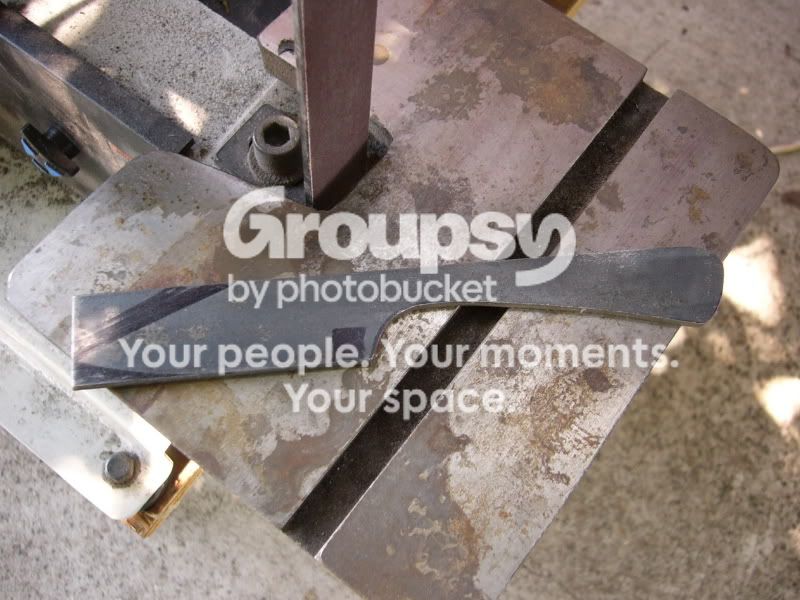

So here we go... I start with copying the original design onto the steel. I’m using 1/8” thick, 1” wide 1080.
Posted Image

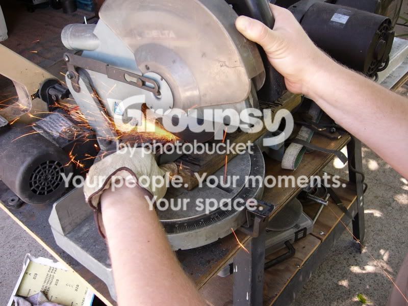

I then use a cut-off saw to do the handle profiling, I leave the blade square for now.
Posted Image
Here is the profiled handle blank after I cleaned up the edges on a belt sander. Notice I left some extra material in the guard area for flaring the guard.
Posted Image

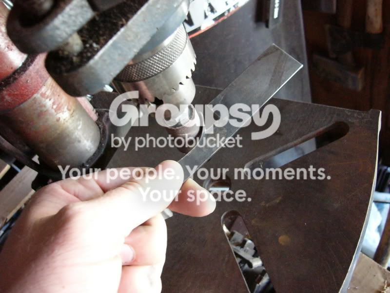

I then use a sanding drum to clean up the scratches from the belt sander and also to make the guard area perfectly round.
Posted Image
Posted Image
The next step is to stamp my maker's mark so I use a marker to help me stamp it in the right place. I also scratch in the lines as the marker disappears when the steel heats up.
Posted Image
Stamped blade. The stamp looks a little off but that will be taken care of later.

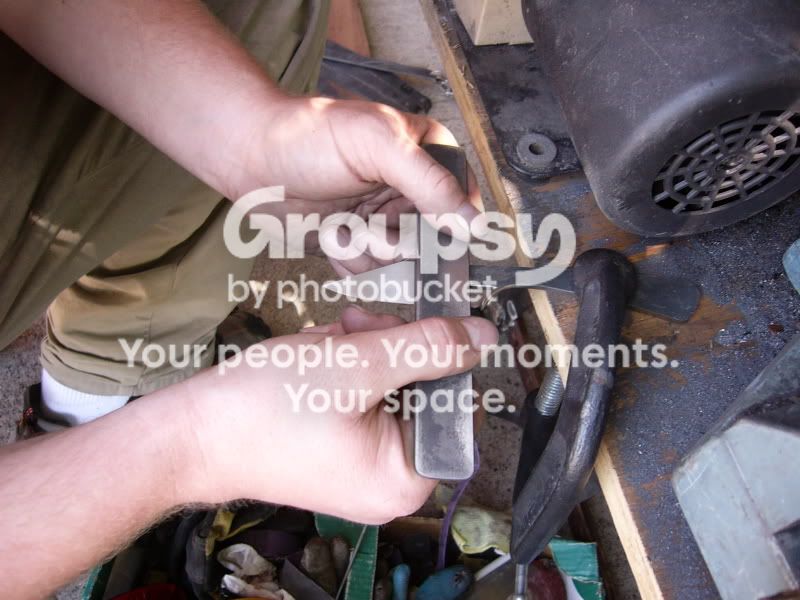

The next step is to flare the guard. I hold the blade with some "tongs" and lean it against a big piece of steel I have clamped in a vise and tilted agains a table. I use a ball peen hammer to do the flaring. I do the flaring at a red heat and it usually takes 3-5 heats to do it.
Posted Image
Posted Image
Posted Image

I have the same Delta sander with belt/disk. The disk on mine is terrible, the key doesn't fit the shaft, and the little adhesive disks don't come off. Judging by the wear on yours, it is not changed too often either.
How well does the Craftsman wider belt sander work for you? How many hp does it have?
Thanks a lot for doing this. I have been interested in your technique since I have seen your first knife. I also watched the video demo of someone doing a simillar technique. I am going to do my best to learn this. It seems cool, and looks great when you do it.

After the discs have been on for a bit, they really don't come off easily. I've found that when I wanna change mine, something that helps is to carefully use a propane torch to warm the disc while it's running, careful not to burn it, but to me it doesn't matter much as I'm usually throwing it away when I'm taking it off. Then stop it, and peel it off. The torch warms the paper, which warms adhesive, loosening it.
I've got a 6x48 craftsman I use to grind my blades that works quite nicely, you just kinda learn to deal with the quirks or you can make modifications.

Thanks guys! Kevin, I use the disk once and never changed the adhesive disk. I use the 4X36 Craftsman to true up the surfaces and for cleaning the spines. HP is 1/2 I think, don't remember for sure.
